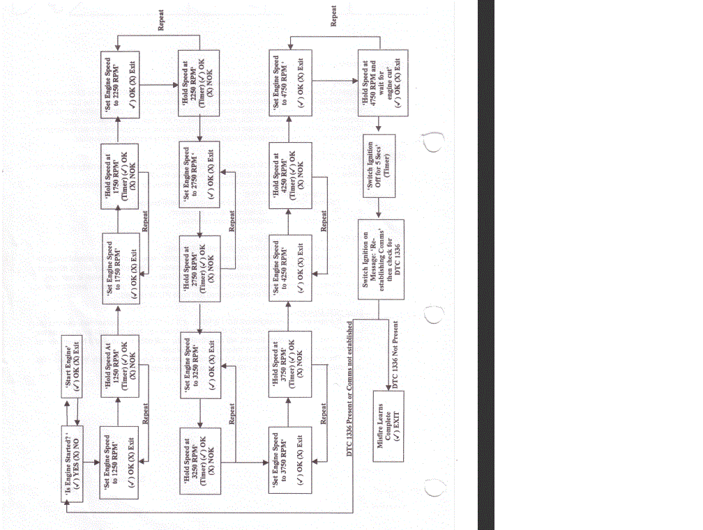

Fick hjälp av Lotus kring denna :) Mail till deras AM support..
Kan hjälpa någon annan
Elise 2001 Onwards:
lf a new engine management ECU is fitted, or if the ECU is re-programmed, connect the Lotus Scan2 tool, and carry out the 'Misfire Learns' procedure.
Note that until such time as the Misfire Learns is completed the MIL will be activated by fault code P1336 and a heater only car may display fault codes relating to 'missing' a.c. equipment.
The procedure may be carried out without the use of a Scan 2 tool simply by following the chart attached and pausing for 5 - 10 seconds at each rpm increment.
Bifogar en fil som beskriver sekvensen
